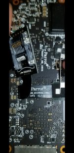

I repair my ANAFI.
The plug is too weak, so if UAV it falls forwards or backwards, it breaks and comes off. the small piece that you see is the tip that breaks.
If you have the fault, they must buy the spare part. The connector is fixed with a soldered fixing sheet, they need a good soldering station. I use a ERSA 150W.

Hi, all I replaced the sd card reader but it still don't recognize any sd card.... I tryed to hard reset battery and drone, but nothing changed.... please help I can not do it alone :(
