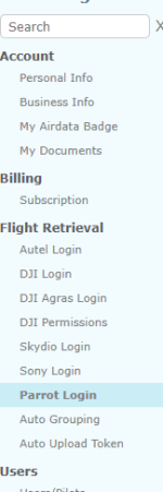

Another option is use airdata.com and sync with your parrot account under Flight Retrieval
/Rafael
