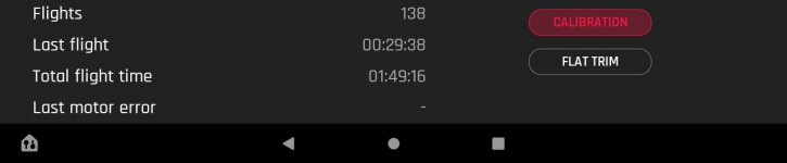

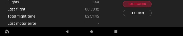

This one people will be interested in:
LIHV 4400mAh charged to 4.3v a cell because my new charger doesn't go to 4.35všŸ™„
100%-5%=33minutes yes 33minutes in hover.
Available UK Amazon=Ā£73.99 for 2
Looks like it would fit in original battery enclosure. I have not tried it as it is something I will not be doing.
