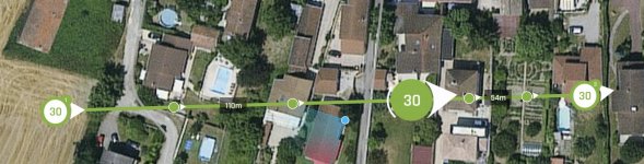

Hello Fabio,
If I had to do that, for example take a vertical picture of the swimming pool between the 2 points below :
I would :
- first turn the gimbal at 90° from the take off point
add waypoint at the exact point where swimming pool is (and where you need to take the picture, see below)
- Then I would edit the flight plan to take a picture at this waypoint (every 2 seconds For example as it is the shortest interval)
- At this same way point, I would add a 2 second pause to be sure the picture is at this waypoint...
In the editing example below, I removed the video for clarity (and to be sure the picture is shot right at the vertical of the waypoint).
Hope this helps...

Hello Fabio,
I would :
Hope this helps...
Thanks! I created a flight plan the way you suggested, I tried it, and the drone did what I needed. Just a question: can the pause of 2 seconds be reduced to 1 second or is it related to the period?
Reactions: MustangPhil
Great if you made it work the way you need !
In fact the pause can be a small as 1 second. I just proposed 2 seconds to be sure to synchronize the ‘1 shot every 2 seconds’ with the length of the pause to be sure you get 1 or 2 shots of the exact position of the waypoint.
I was mainly suggesting the ‘pause’ function, because it adds an event in the navigation timeline and you don’t get the ‘take a picture event’ during the rest of the trip.
The advantage of 2 or 3 seconds of ‘pause’ is to get the Anafi stand still during the shots to avoid motion blur on the images...
You may try 1 second after the waypoint and test if you get your picture ? (I’m not an expert and never tried that)
