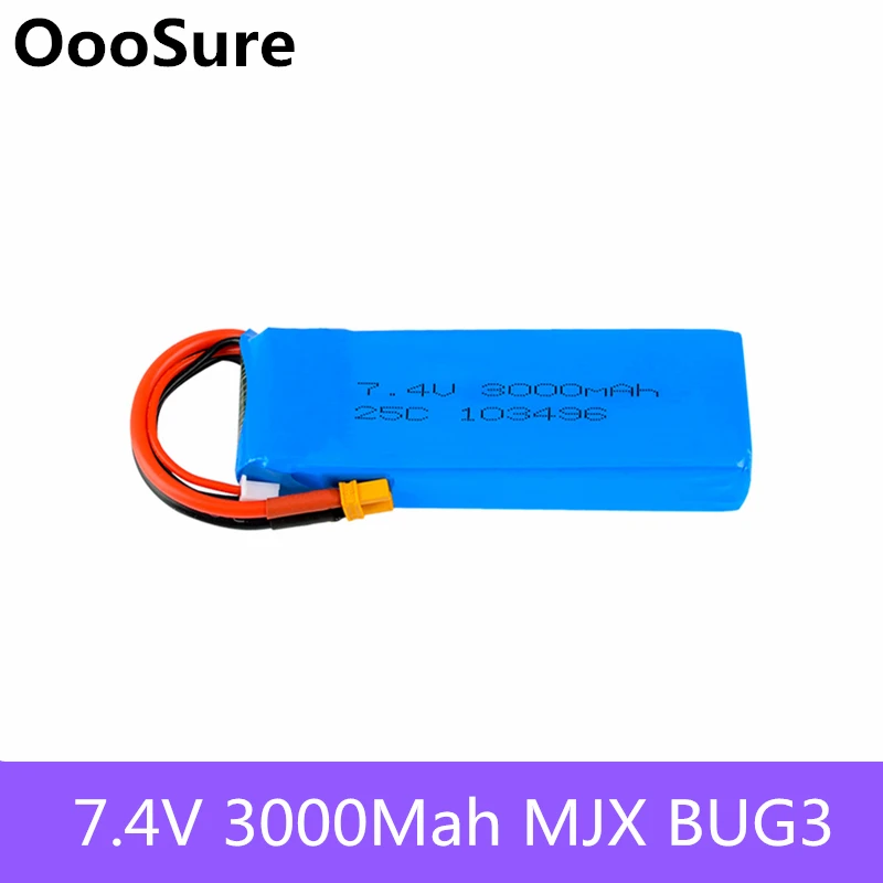

for now, I think the best choice for myself, even if it’s bigger than the Anafy battery case, is this one :

That’s right. And the size is interresting because the width is good. But... I don’t know the risk to charge standard lipo with 4.35v..
They would need to be charged with an external LiPo charger. Charging LiPo batteries to 4.35v/cell would end in tears as the battery might burst into flames, swell and damage the battery board or at least damage the internal chemistry. Don't do it!
It is very cheap to get a balance charger and it needs to be charged with non-Anafi USB. The connector must be left and connected to the Anafi card, then disconnected after use and connected to an external charger. It may be enough to leave a single disassembled anafi smart circuit and connector connected to the Anafi in place and just replace the cells. The% pointer will not show correctly but can be used based on voltage (thanks to Anafipilot1).
It's all just theory, I haven't tried!
It seems easier to use some Lipo HV and the anafi usb-c....
But... Is there an electronic solution to adjust the charging voltage at 4,20v instead of 4,35v ? ...

Anyone know the physical dimensions of the cells inside the Anafi battery? I wondered about splitting up one of these batteries to replace the cells in worn out Anafi batteries:
It's too big. The anafi battery is approx. 30mm wide. And this is 62mm
This is because these are 5200mWh cells and the Anafi has 2750mAh battery cells. What could be more good is the 3000mAh
Yes, but I was thinking of dividing the cells in half. Not sure which way the cells are stacked.
The cells are on top of each other because they are flat brick-shaped. Always. What you linked to is very big. Its size is already due to its capacity. Such an Anafi-sized cell is only available with such a small capacity (around 2500-2800).Akku.jpg
