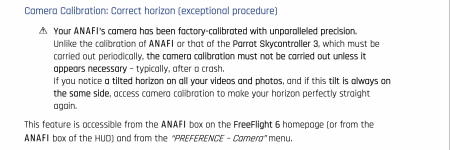

I believe what you are asking for is in camera calibration via the drone icon.Every now and then I can't launch from a level surface and I need to tweak horizon. Can someone tell me where the roll adjustment is? I know I've used it before, but I can never find it again.

The surface on where you land has nothing do do with if the camera is level or not; gyroscopes in the gimbal know what is 'down' by turning the gimbal during the calibration.
