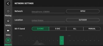

Hi. Try to set wifi like that :
United states outdoor
Pls see screenshot.
You will only get the longer range if you use the Skycontroller. The range using just you phone will be a lot less.
