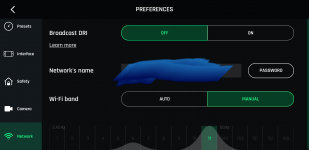

I just learned that tere are no regular 5ghz from 36-48 channels to choose from or DFS only 5.8ghz wifi channels. Why does FF6 disallow these?

Looks like you are in CE mode and not FCC mode. What country are you flying in? FF6 determines a country code and only allows certain channels based where you are located.

In FCC mode you should see channels 1 thru 11 and 36, 40, 44, 48, 149, 153, 157, 161, and 165.

Great news! All 5ghz channels are back and power level is FCC. I did the reset through the gui of FF6 hidden at the bottom of anafi information page and that one worked. I don't know why there are 2 reset options. I guess I am now out of CE mode as well. I am not certain what caused this but my phone was listed as another country in android - general management - date and time - time zone - region section, when I set it up. Set to US there and saved, then reset anafi. Now anafi GPS is giving me the correct time as well for after flight reports on FF6 flights. If your GPS flights have the wrong time, that is how you fix it. If you are traveling out of US, with drone change that back in android settings to whatever country then reset anafi and back in CE mode. Pretty cool huh?
