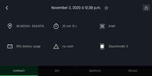

Just came in from the back yard. First battery that came with the Anafi.
44°F outside right now. Not to bad of a day. This battery is the one that spent 3 months outside in a tree in the winter in Northern Ontario. The total life percentage of the battery as of today is 87%. It has been charged 68 times. From start to landing it flew 20 minutes and 19 seconds. It used 99% of the battery during this period. It gave a Auto landing message at 12% saying it will auto land in 3 minutes. At 1% the Anafi auto landed.
So this about the 3rd time I have conducted this test over the last 6 months. Never has it tried to auto land at a higher percentage and it has never just dropped and shut off. So either I have one of the better Anafis or there is another reason unknown to us. Some how I don't think we will ever know.
As you can see the battery has seen better days :)
Duct tape to the rescue
