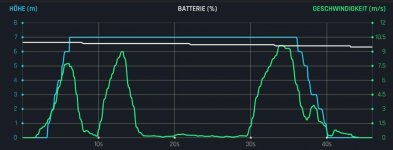

Reading her for some time since my 2 years old anafi battery is apperently done. I had 3 times automatic landings despite the battery showing around 60-80%. log.jpeg
