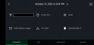

I was in my yard and the drone was hovering 3' off the ground, it just went quiet and dropped.
I went thru my phone to find the log for that flight, I do not know how to open or use it to see if it's a battery error or what happened. I have isolated the battery that this happened with and won't be using it until I can find out more.
I am running Android 12 on a Pixel phone, All batteries updated and so was this drone and controller in the last month. FF6.76
250838752_404775354447474_8430757742361990059_n.png250994476_6976916625655370_4111914531320350833_n.png
