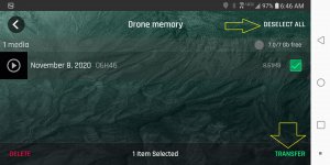

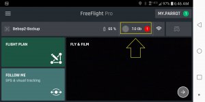

Please help me out how download by WiFi with pc. I connected to mi bebop2 wifi with mi laptop but i dont know how to proceed. Thanks and sorry for mi english
You can't use a PC to transfer the files. You have to use Freeflight pro. Where you see the drone memory, tough there. It will open up the second screen and touch "Select all" (showing as deselect on screenshot) then press the "transfer" text. Once the files are transferred you will see an option to keep or delete the files in the drone memory. I delete them to free up space.
Then connect your device to the pc and you can copy the drone files from the device. Android devices if I remember right is
internal storage/dcim/bebop 2
