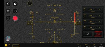

My software work is an experimental extension/modification project based on Parrot’s original FreeFlight Android application.
I named the layer I added AGENA AeroCore. This name refers only to the HUD, control panel, autopilot control logic, and related features that I developed; it is not the name of the Bebop’s main firmware or Parrot’s own flight-control software.
My goal was to preserve the Bebop’s existing Parrot infrastructure while bringing its user-side flight interface and automatic control capabilities somewhat closer to an aircraft-style Automatic Flight Control System (AFCS).

Therefore, AeroCore is not a replacement flight controller for Parrot’s core stabilization and motor-control system. It is an experimental guidance / automatic-control layer added on top of the existing Bebop platform.
The project is still under development. I am currently continuing to test and simulate the control algorithms, telemetry handling, mode transitions, and safety/disengagement logic. For this reason, I do not consider it a finished or production-level flight system at this stage.
The screenshots I have shared show the current AeroCore HUD/MCP interface, flight displays, and the physical modifications made to the drone.
