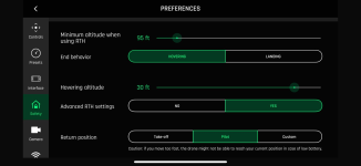

All works well, except I cannot understand the Return to Home feature. I tried many times today, but in most cases, when I press the Home button, the drone rises or descends to my preset hovering altitude of 30 feet and then just hovers there. It doesn't return to its take off point or to where I am standing.
What I am doing wrong? Here's a screenshot from FreeFlight 6 where I experimented with the Return to Pilot setting. But it didn't return to where I was standing and I didn't move my position at all after I pressed the Home button. It just descended to 30 feet without changing its location at all.
Any and all suggestions are appreciated.
