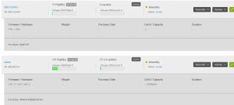

hello,
I bought a second hand battery, which looks exactly like my original battery, has a serial number. When I look in FF or DroneLogBack, I don't get any hardware or firmware version. Was there more than one battery version and I would have bought an "old" one, not quite compatible with my drone (bought in September '21). Or maybe I got a "compatible" version but not the original one (although the exterior is strictly identical) ?
c.
Smart Battery Date10/02/2021
Smart Battery GFW Version26100022001c000385
Smart Battery Serial NumberB8G122403
Smart Battery USB Version0.10
Smart Battery Software Version1.1.18.0
so the software is up to date. Strange :/
