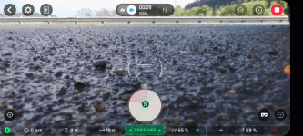

Was having the same issue. I had recently purchased a used Ford off of eBay and was quite disappointed when I simply landed my drone and then received the barometer message. I took off the nose cone and noticed that on the GPS unit where the ribbon cable plugs in it was not seated all the way perfectly and the retainer clip was not down. Honestly it looked like it was connected just fine I would have passed it up under any other day but for some reason I felt a little anal about it so I clicked it in. I went ahead and fired it up and now it works perfectly! Who would have guessed LOL hope this helps somebody! Try this before you buy a new main board!
