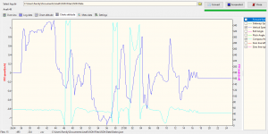

I have screenshots of the last flight from ShowAnafiLog, any thoughts on this? (I will try again in a more still day, do a compass recalibration...) My confidence has been shaken somewhat! I am used to either a fully manual drone where I have complete control, or the Matrice 210 which is just rock solid.
Screen captures here

The screen captures that you have posted do not have the legends which makes deciphering them difficult. It would be better if you attached a copy of the relevant .json file(s) so that other experienced members can see the raw data which is necessary in order to even have an educated guess as to what is wrong.
Hi Thanks for the reply. I had good (green) GPS lock before I took off. I did compas calibration twice, (once indoors, but I knew that woudl mess things up, so I re-did it out doors.
Good shout on the graphs, my bad!
Will edit the original post so it has the key. If I can work out how to remove the GPS location from the log files I will be more than happy to upload!
New link
OK I have adjusted the first few numbers of my lat/long by a fixed amount in order to hide the location, apologies for my paranoia!

Looking quickly at your .json file there appears to be some corrolation between the vertical speed and the compass heading. A sharp rise and then drop in vertical speed occurs jarround a rapid change in compass heading even though the altitude does not appear to change very much.
It may be just a coincidence but do your videos show a similar corrolation? Can you please check the propellers with a magnifying glass for any nicks and micro cracks and also check that the propellors are not too tight a fit on gthe screws. I assume that the Anafi is brand new, and not second hand, and that the propellors are OEM and not after market.

You are right on the change in altitude during these yaw manoeuvres, but I feel those were induced by me putting in some sharp downward control movements when the drone seems to stop responding to my commands. Unfortunately I didnt have auto video record turned on at this point, I was going to focus on stills. From memory the yaws started during level flight but I could very easily be wrong here.
