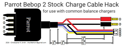

Hello Parrot Team,
I have a Bebop 2 Power, I have the problem with the batteries that do not charge correctly because the cells are not balanced, so I decided to make a cable to charge it using the same connector of the original FX30B-4P-3.81DSA20 batteries and taking out 3 connectors, the positive and negative poles and the 3S JST-XH balancing cable.
And I don't know if I can make it work with other LIPO batteries at the same time by making another adapter with the FX30B-4S-3.81DSA Female connector output and in the input of the Lipo battery an XT-60 Female and a 3S JST-XH male.
If anyone has tried it or can tell me if this would work, I would appreciate it.
