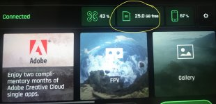

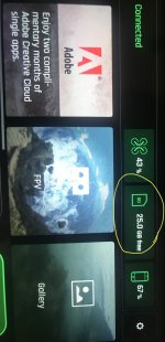

Hey everyone i have a parrot anafi that flies normal and can still control gimbal and everything else seems like i have lost video feed on app and unable to access video features too.
Can anyone suggest any fixes? Attached are screenshots.

I did and even tried wifi on different phones, still the same result :(
Did your Anafi have a big crashing before the video streaming loss? If yes, I suggest you that to check the vertical camera's cable-connection on the mainboard's socket!!
Nothing to do with the vertical camera.
When what you have happens it is normally connection problem between front camera and mainboard - check the video cable it may have disconnected.
