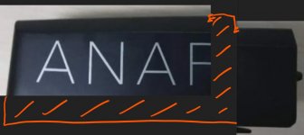

Here is a quick concept which may work.
-it must not make the case any longer (to keep the USB charge circuit attached to the battery board)
-increase height for the extra thickness of the additional 2 cells (keeping in mind that USB circuit flex cable)
-add grooves
Epoxy and glue should do the rest.
The battery case will be cut between the power button mechanism and the locking mechanism.
Only the rear part of the case, past the locking mechanism, will be raised
The adapter will be added in the area shaded in orange.
-add grooves
I have a 3D printer and I can design. The problem is that my batteries are still good and I don’t want to disassemble yet. If I grow old too and have to take it apart, I’m planning a new shell for it.
Or if you undertake to make sketches of the parts that can be built into the battery by measurement (to the nearest tenth of a mm), I can design it and you can print it out. This would require the size of all panels and cells. The height of the LEDs due to the cutouts. I can measure the dimensions of the original battery from the outside, but not the inside.

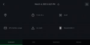

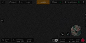

I had some extra time this week. Worked on my battery mod.
It was initially unsuccessful. The charge board was disconnected a long time ago, but based on Solaris' instructions should not have been.
Grabbed another old battery, and this time appears to be a successful mod.
The old cells I may use with my FPV goggles, depending on how healthy they are.
I'm considering wrapping the whole battery with clear shrink wrap, then cut out the bottom shrink wrap(to allow the battery to easily slide in its slots) . What do you guys suggest?
I will try flying my headless Anafi (removed the gimbal) with this battery when it is fully charged.
My Anafi is headless because I did not see the value in paying US$399 (same as a refurb) to get it fixed by DroneNerds and end up with no extra parts.
I was given the option to have the diagnosis fee waved and sent back to me, only paying the shipping cost.
I will wait for when a deal comes up.
